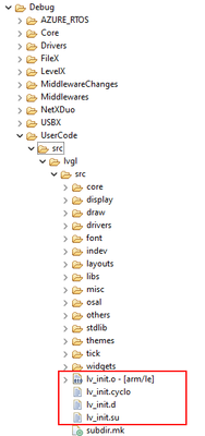

The CubeIDE linker doesn't seem to work properly... Any help would be greatly appreciated. ST Employee help?????
1- In the UserStartup.c, I call lv_init();
2- After compiling, it says it cannot find lv_init()
3- I see that the file lv_init.c file got compiled (lv_init() is defined in that file) - the object file was created lv_init.o
4- It seems the linker cannot find that file....
Is there a limitation on the number of files the linker can handle?

I'd be really happy if the bug is between the chair and keyboard, but things seem to be pointing to the compiler. Also, in the pre-compiler, there seems to be a problem with the includes.
In one file (early on in the compile), it has no problem finding the "#include "lvgl.h" file. as the 6 min compilation continues, files compiled later with the same "#include lvgl.h" generates and error: "Cannot find include file"
If I change the "#include "lvgl.h" to the real path, and not using the include search path, then the file compiles... To me this looks and sounds like a compiler limitation....
Also, there seems to be a limitation to the number of SRC directories defined in CubeIDE (max 10). Most were autogenerated by CubeMX. I know this is a large compile and we are definitely pushing the limits of the IDE.

@matt-crc wrote:3- I see that the file lv_init.c file got compiled (lv_init() is defined in that file)
Is it?
You haven't shown that
2025-03-27 5:22 PM

Can you copy the full contents of the Console tab from a clean build into a text file and include it here?
2025-03-28 8:37 AM
Hi @TDK
Funny that you suggested that... I've been trying to do that for days.... Unfortunately I can't figure out how to capture the entire console. It scrolls past the console buffer size, so I can only get the bottom 1/3 of the project. Is there a setting that increases the buffer size? I see there were some warnings when compiling but I haven't been able to scroll back to see them.
BTW, I finally reduced the size of LVGL component by unconfiguring a lot of options and finally got a working executable. I was going to run it this afternoon to see how it runs on the hardware.
