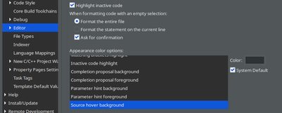

did you try basic color setting, not dark (as i have) , but light ...?
>allow you to achieve a maximum white background for all windows except the one where you edit the code.
afair this is from system default , somewhere (!) you can change this to custom color...but i dont remember now, was searching some time for this.
...like this:

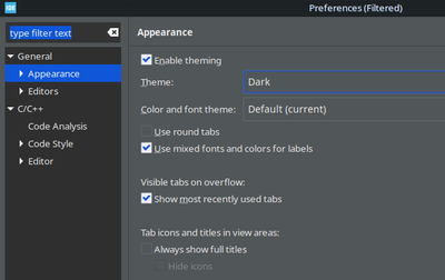

Hello @ADrub.1
Thank you for posting!
Have you tried to switch the Colors and font theme as "Default"?

Hello @ADrub.1
Actually, STM32CubeIDE is not supported on the Linux Mint OS yet. Below are the supported operating systems and architectures for STM32CubeIDE 2.0.0:
• Windows® 10 and 11, 64 bits (x64)
• Linux®: Ubuntu® LTS 22.04 and LTS 24.04, and Fedora® 42
• macOS® 15 (Sequoia), macOS® 26 (Tahoe)
However, try to restart CubeIDE or check the system settings to see if it enforces dark mode.
BR, Souhaib

2025-11-24 1:40 PM - edited 2025-11-24 1:44 PM
...like this:
