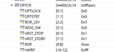

Show a screenshot of the contents of the FLASH_OPTCR register just prior to the line where you set HAL_FLASH_OPTCR_OPTSTRT.
There aren't any mechanisms for getting to RDP level 1 without modifying the option bytes and applying via the OPTSTRT bit.

Before executing the line where I set HAL_FLASH_OPTCR_OPTSTRT:

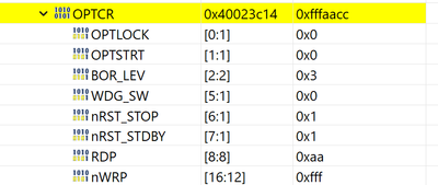

After Executing the line where I set HAL_FLASH_OPTCR_OPTSTRT:
After Executing wait instruction for Busy flag to be cleared:

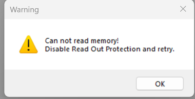

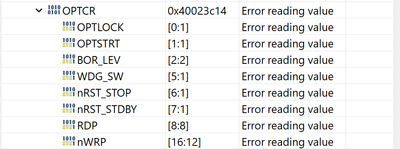

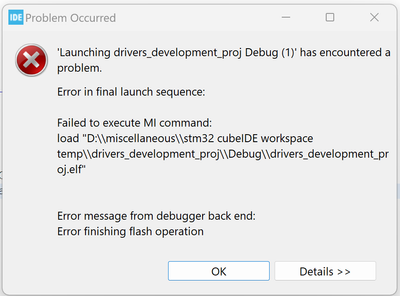

oh, almost forget, after the end of debug session, if I tried to open a new debug session or burn the code, here is what I got:
and if I tried to connect to the board using the ST-Link utility, here is what I got:
so in order to return back to RDP = level 0, I click on Target->option bytes->select Level 0 and then Apply.
