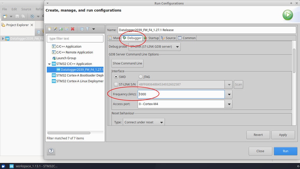

Random errors occurred when selecting SWD frequency at AUTO or above 1000kHz.
Tested with generic ST-Link V2.
In STM32CubeIDE 1.12.1 the same behavior does not occur.

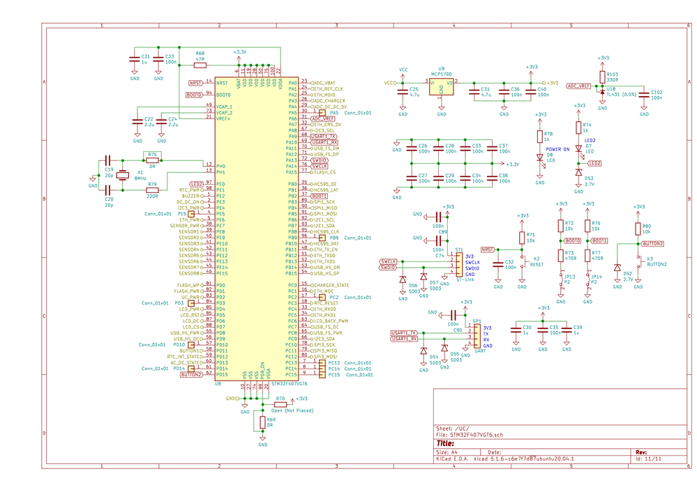

It is a customized board, based on DiyMore STM32F407VG board, the schematic is available:
Complete schematic: https://github.com/rtek1000/Datalogger_2039/blob/main/Hardware/Datalogger_2039.pdf
