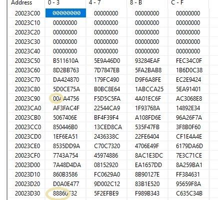

We have had a HardFault error in the field and wanted to use an old technique of storing the info in RAM until after the micro is reset and more stable and then move it into flash. We used the STM32G0B0RETX_FLASH.ld file and modified two spots:
/* Memories definition */
MEMORY
RAM (xrw) : ORIGIN = 0x20000000, LENGTH = 143K
RAM_FOR_FAULT (rw) : ORIGIN = 0x20023C00, LENGTH = 1K
FLASH (rx) : ORIGIN = 0x08000000, LENGTH = 502K
and
.faultData :
. = ALIGN(4);
__faultData_start__ = .;
*faultData.o (.text .text*)
__faultData_end__ = .;
. = ALIGN(4); */
} > RAM_FOR_FAULT /* new RAM for hard faults */
ASSERT( LENGTH(RAM_FOR_FAULT) >= (__faultData_end__ - __faultData_start__), "faultData overflowed !")
Cube's IDE show the sections seems to work:
But once the debugger is loaded there seems to be a lot of random data around the 0x20033C00 memory spot:
Could the stack still be using the chips high RAM address or is there something else we need to do to isolate the highest 1K of RAM?
Thanks...
2024-07-16 1:49 PM - edited 2024-07-16 2:34 PM
Looks pretty random to me.

I encourage you to pull the power, wait for for 5 minutes (and wave your heat-gun on low over the chip) then repeat the test - because I'm not sure what we should expect to see and I'm curious to know. But this looks very much like random data.
Update: follow up to DeLorean's suggestion below - the SRAM cells might exhibit preferential (value-dependent) bit decay behavior. Try filling with all-zeros/all-ones, and repeat the power cycle test. See if a pattern emerges.

Define "Random" in this context.. looks like random non-specific junk to me.
How about, if you don't see your Hard Fault Magic Tag at reset, you explicitly clear this 1KB of RAM with something specific, like 0x00 or 0xCD or something.
Then next time you reset, post Hard Fault, you check/dump the content, and perhaps have your Hard Fault journal through this RAM space, so you can hold/see multiple frames.

I just trying to do my do-diligence to insure I have not messed anything up(the linker files I've not dealt with RAM settings before.) The RAM data could be random but I honestly would be surprised at the distribution of one's and zero's. I kinda expected more clumps of one or the other(0x000 or 0xFFF) but the last processors I've looked at this closely at was 15 years ago.

Just make sure the memory is correctly defined in the link script (and your code does not clobber it, and there is no activation of the built-in bootloader etc.). Test.
The SRAM content should survive MCU reset, while the power is maintained. If this MCU has a 2nd SRAM module or "backup memory" try these too.

I know that's true for DRAM (given enough time), but I don't know if it's true for SRAM, which uses a different kind of basic cell to hold a bit. The pattern of charge decay in SRAM may be different. That's why I suggested you do the extra tests I described. They would have told you whether memory remnance effects and non-deterministic decay times explain what you're seeing.
If you're talking about what true random data actually looks like, humans are notoriously bad at evaluating that. That's why human-generated "random" data usually fails statistics tests.

You are probably correct. Long power cycles still result in the same type of data in RAM even after it had been cleared. It all seems to work after software resetting the processor from a induced illegal address write including the simple checksum verification. If anyone wants the code let me know and I'll post the two functions needed(one in the HardFault handler and one in main.
After digging around the HardFault so much I'm going to put a quick stack fill to trace how much the current code base is using.
