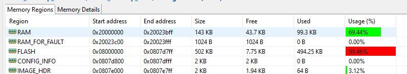

Cube's IDE show the sections seems to work:

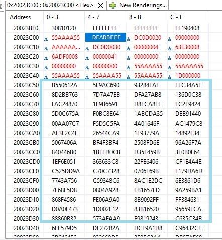

But once the debugger is loaded there seems to be a lot of random data around the 0x20033C00 memory spot:
Could the stack still be using the chips high RAM address or is there something else we need to do to isolate the highest 1K of RAM?

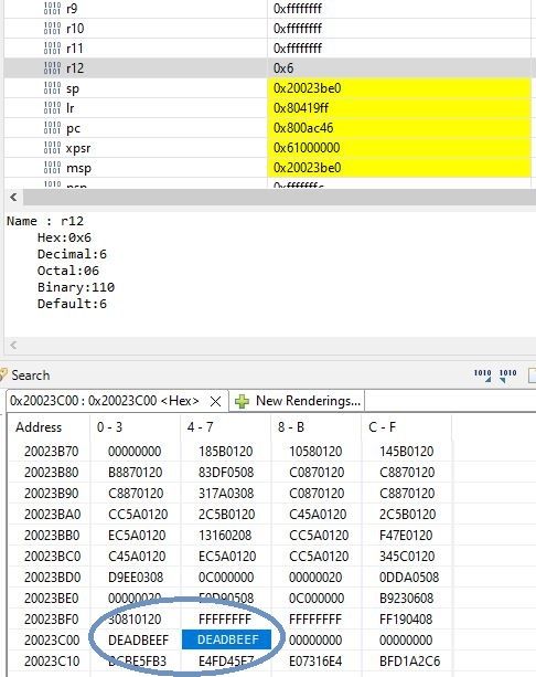

If we stop at the beginning of main() and step into the first functions call, it appears to load data onto the stack at about address 0x20023BDC and then start using lower RAM addresses:
So the stack appears to start correctly from main. Is there a difference between a power up condition and a reset where a power up may use those high RAM addresses?

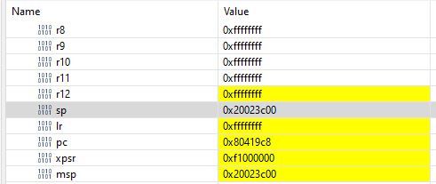

So at the Reset handler, the stack pointer shows 0x20023C00.

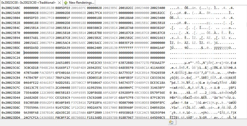

If I fill in random data and run till I hit main(), the random data is still present.
Do power up conditions use the highest RAM addresses? If it only happens on a power up(and Not on a reset), this would work fine for a HardFault problem.

This is true, but if the linker has worked correctly and high RAM addresses are never used, there should only be random data up there. I've never seen random data look like like the RAM high addresses I'm seeing in the debugger. It is either the Segger debugger or something to do with a power up vs debugger reset difference.

It is the data in addresses above 0x20023C40. The linker is supposed to reserve the last 1K of RAM and we use a data structure that is written to during a HardFault starting @ 0x20023C00. The RAM above the HardFault data structure(see the RAM above the red below) does not seem to change on a Debugger reset but also does not look random to me.
Was hoping someone knew the gory detailed answer of if this is caused by the power up of the micro as dumping it out a serial port is a pain.
