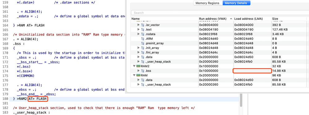

How can i set the ram2's load address like as ram?

When build the project, the ide generate the bin file and include large mount of zero at the end of the file. I try to set the ram2's load address to solve this problem.Is there any other way?

Check the map file, what is actally loaded at at those addresses filled with zeroes.
What else did you change in the linker file?
