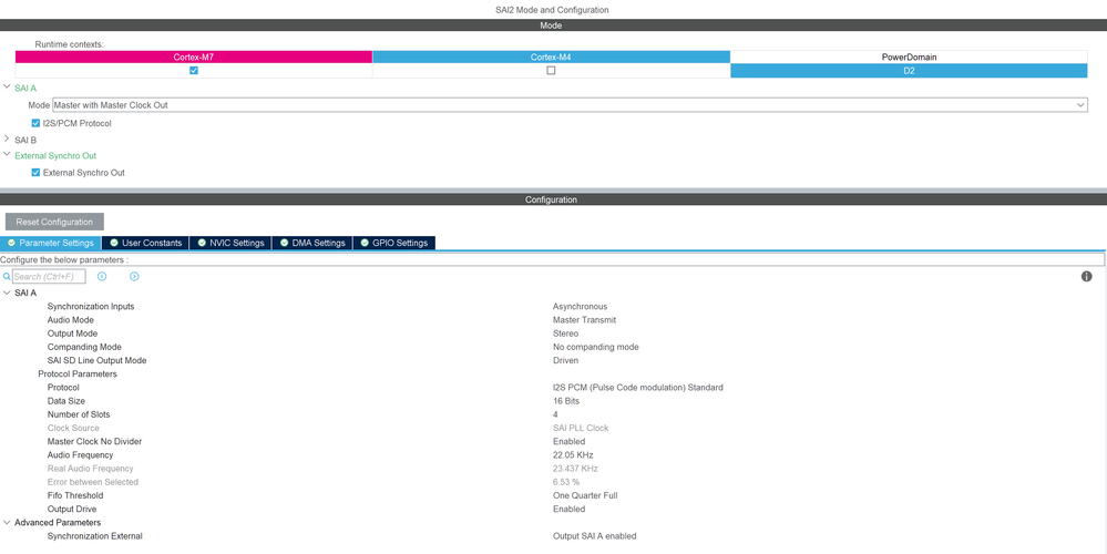

So - the clock for SAI is set to 4.096MHz. I use SAI1 configured as on the screen:
0693W00000WLEAFQA5.png0693W00000WLEAKQA5.png0693W00000WLEAPQA5.pngHere's my code:

OK, now the generated code:
static void MX_SAI1_Init(void)
  /* USER CODE BEGIN SAI1_Init 0 */
  /* USER CODE END SAI1_Init 0 */
  /* USER CODE BEGIN SAI1_Init 1 */
  /* USER CODE END SAI1_Init 1 */
  hsai_BlockA1.Instance = SAI1_Block_A;
  hsai_BlockA1.Init.AudioMode = SAI_MODEMASTER_TX;
  hsai_BlockA1.Init.Synchro = SAI_ASYNCHRONOUS;
  hsai_BlockA1.Init.OutputDrive = SAI_OUTPUTDRIVE_ENABLE;
  hsai_BlockA1.Init.NoDivider = SAI_MASTERDIVIDER_ENABLE;
  hsai_BlockA1.Init.FIFOThreshold = SAI_FIFOTHRESHOLD_1QF;
  hsai_BlockA1.Init.AudioFrequency = SAI_AUDIO_FREQUENCY_22K;
  hsai_BlockA1.Init.SynchroExt = SAI_SYNCEXT_DISABLE;
  hsai_BlockA1.Init.MonoStereoMode = SAI_STEREOMODE;
  hsai_BlockA1.Init.CompandingMode = SAI_NOCOMPANDING;
  hsai_BlockA1.Init.TriState = SAI_OUTPUT_NOTRELEASED;
  if (HAL_SAI_InitProtocol(&hsai_BlockA1, SAI_PCM_SHORT, SAI_PROTOCOL_DATASIZE_16BIT, 4) != HAL_OK)
    Error_Handler();
