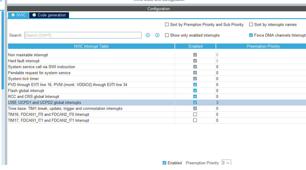

This is related to your interrupt prio level, at 0 it is in conflict with the systick.
Please put it at 0x3.
2021-07-27 7:49 AM
you mean like this? Still not working.

Solution for me was to enable interrupt in the configuration page shown above. However I would like to know:
Do I need to change the preemption priority level? If so please explain why.
i.e. HAL_NVIC_SetPriority(USB_UCPD1_2_IRQn, 0 or 3, 0);
PS. I consider it a bug in CubeMX, that the interrupt is not enabled automatically (like it is for a F401).

I noticed you're using STM32Cube FW_G0 V1.5.0 which is higher version than mine.
So, I downloaded the latest STM32CubeIDE1.7.0. Guess what? It's working now.
I'm not sure what it was. I assume the new version just fixed something.
