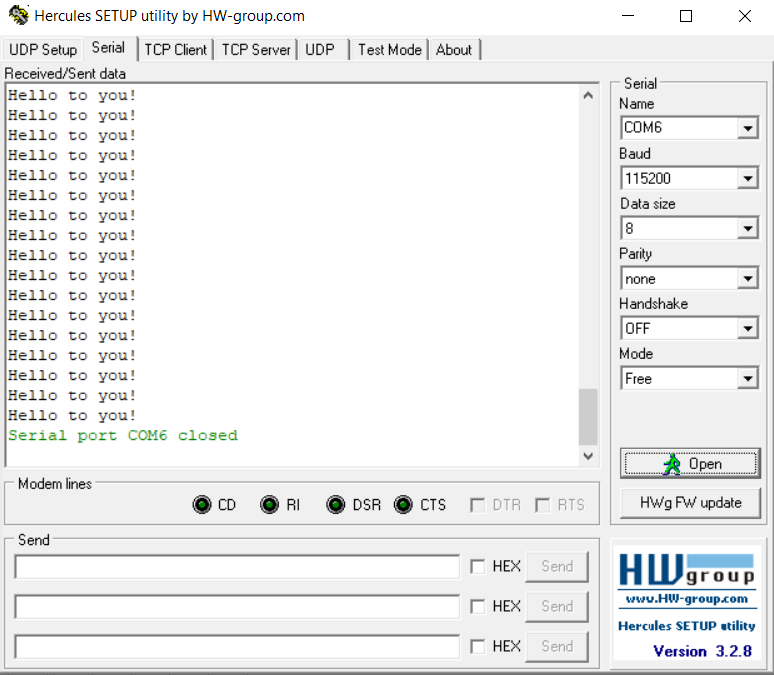

Now when I thinking of it!
Yes! The board need first connection because the uC is tooo fast.
If I unplug the USB cable completly, then USB connection wont establish.
But if I just drag the USB cable out 2-3 mm, but still have current source connection to my uC, then press the USB plug in again.
Then I get USB connection :)
Thank you!

2021-07-06 3:13 PM
By the way!
It works much better if I place MX_USB_DEVICE_Init(); closer to MX_GPIO_Init. Then I will have connection directly when I plug it into the PC.
