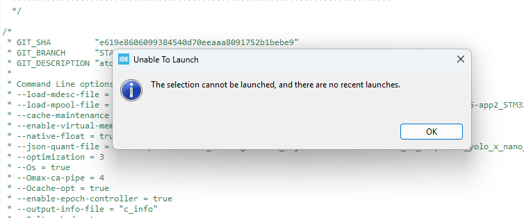

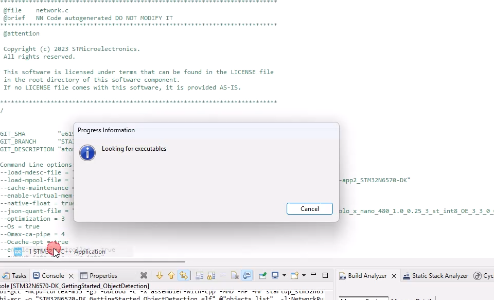

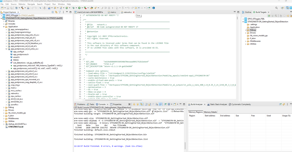

Loaded the project to stm32CubeIDE 1.19.0
Can buid the project
but impossible to configure or debug the application !!
or this error on debug view
If someone can help ...

2025-11-13 7:35 AM
@Souhaib MAZHOUD thank you but i can't open debug configuration ... nothing happen (no popup windows open)
2025-11-13 7:36 AM
Thank you but we can't use cubeIDE to program and debug the N6 ??
2025-11-17 2:21 AM
