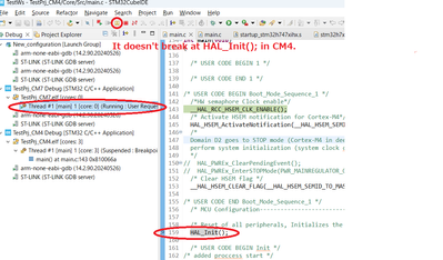

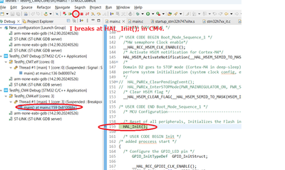

I configured STM32CubeIDE following AN5361 and I started debugging. I noticed next behavior.
When main in CM4 was selected and I started debuging, it broke on CM4, as shown in image below.
It is the case that breakpoint is set at "HAL_Init();" line in CM4 main function.
But, when main in CM7 was selected and I started debuging, it didn't break on CM4, as shown in image below.
In this case, LED1 didn't turn on. LED1 turning on proccess is in CM4. So it will not go to CM4 code.
I think that after reset, CM7 and CM7 is started at the same time. But one cpu only starts, mentioned above.
Could you tell me the way how both cpu is started at the same time on debugger?
