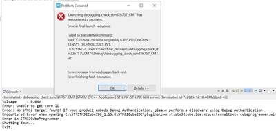

2025-07-06 11:50 PM
I am getting this error while I am debugging both cores simultaneously.
