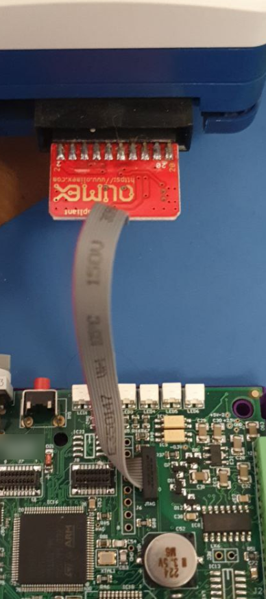

Re target cables, I have done all kinds. This is the shortest I can do. I am using the Olimex 20way to 10 way adapter and a very short 10 way cable (out of the STLINK cable set) and you can see how close the CPU is.
If I plug that 10 way cable directly into the 10 way socket in the debugger, it works but much less reliably than using the 20 way socket on the debugger.
