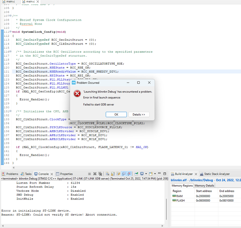

Can anyone help me solve the "failed to start GDB server" error.
H.Ahmed
Associate II
I'm trying to program STM32F103C8T6 using CUBEIDE. After solving so many errors now I have this error " failed to start GDB server" tried different PORT NUMBERS and also changed debug prob from " OPEN OCD" to "GDB SERVER" but could not help.

MM..1
Chief III
Seems your ST-Link or MCU dont work. Checkthis all first in STLink utility or STMCubeProgrammer sw.
After work try back in debuger.

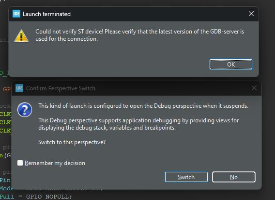

mattias norlander
@H.Ahmed​, the STM32F103C8T6 is an MCU which has been particularly subject to cloning by competitors. Maybe because it is embedded on the popular Bluepill board.
The debugger is here detecting that the MCU you have is not a genuine STM32 device. We will never allow non-genuine STM32 devices to be used with our tools as I hope you can understand and respect.
Out of curiosity: From where did you buy this board or MCU?
In general, the only thing I can recommend is to buy MCUs and boards from trustworthy suppliers.
@PHolt.1​, did you read the error message in the OP screenshot? Are you 100% certain that your struggle with ST-LINK debug comes from the same root-cause. I am quite skeptical. Either the device is fake, or it is not. With fake devices I assume we would deny debug 100% of the time.
Feel free to post your screenshots and log-files when you run into debug issues every ~10th launch, and maybe we can find the root-cause. I think we are mixing apples with bananas in this thread. :)
Kind regards, Mattias
