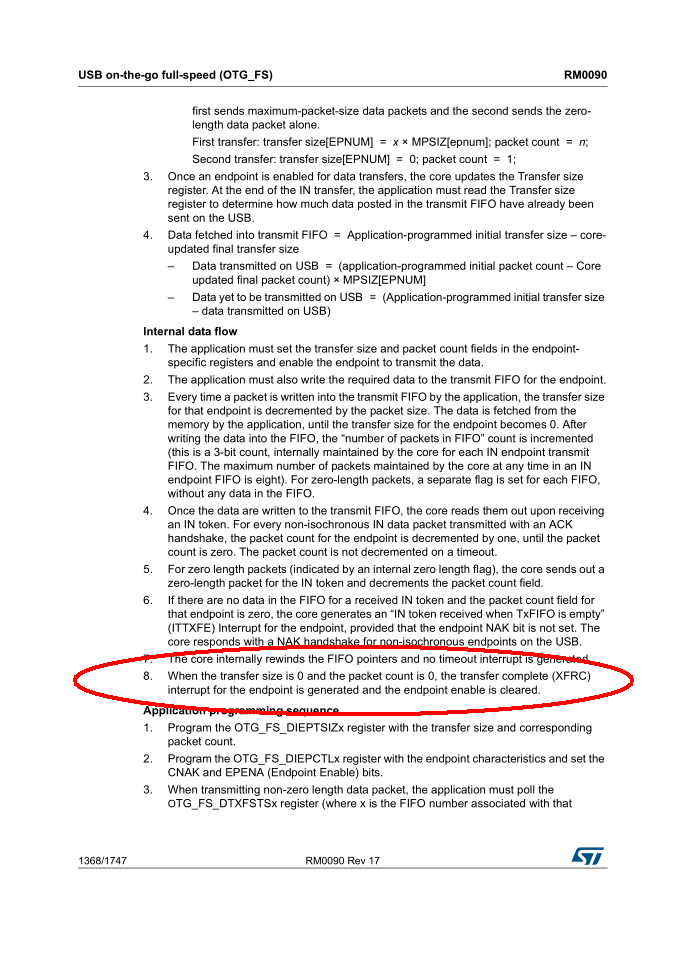

> My Q is whether there is any way to tell when that data has been consumed.
Yes. And it's described exactly where you would expect it: in the manual.
It's used in multipacket transfers.

> So there should be a "transfer complete" interrupt somewhere.
Yes. And the manual clearly says, where and how it is called.
> I don't think it has been implemented.
In hardware? Of course it is. In Cube? I don't care but yes, it is, in some way. Look it up, Cube is open source.

2022-09-05 3:01 AM
OK looked it up for you in a 'F4 Cube v1.21 CDC example.
The In XFRC interrupt calls HAL_PCD_DataInStageCallback() (or the same through the "registered" mechanism) which as with all callbacks is implemented as weak and is supposed to be implemented by user.
The CDC example implements it as a straighforward call to USBD_LL_DataInStage(), which for non-EP0 implements the multi-packet transfers and finally calls pdev->pClass->DataIn(), that in the CDC example points to USBD_CDC_DataIn() and that appears to signal through hcdc->TxState = 0;
