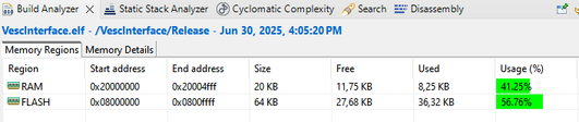

I have this project for the STM32F103C8 where the build analyzer of STM32CubeIDE says that only ~57% of flash is used:
but while I'm flashing, it shows that the erased sectors are 0 to 56 (out of 63):
and also using the STM32Programmer I see that the empty region starts at 0x800E048
Now 56/63 ≈ 0xE048/0xFFFF ≈ 87% which is 30% higher than the stated 57% of build analyzer. This is kind of a bummer because now I will have to upgrade MCU since some other features must still be added to the project.

I have finally found what is happening here.
When running the code from the CubeIDE via EITHER these buttons it always loads to the MCU the debug version (regardless of the active configuration). While I thought that the rightmost one would have loaded the current active configuration (which is always set to "release").
The build analyzer on the other hand shows the size of the active configuration (i.e. "release").
Therefore to load the "small" version of the firmware I have to start the build all, and load the hex from the release folder using the STM32CubeProgrammer (or probably I will use an STM32_Programmer_CLI.exe command placed in the post-build, but I also think that there is a possibility to change the run configuration).
To me this is good on one side (i.e. I don't need to switch to a bigger mcu because the remaining 43% is enough to complete the project) but it also means that from a certain point onward I won't be able to debug the code, but only run it.
Thanks to all the contributors to this issue, I hope that this may help someone else.

2025-07-01 1:35 AM
I am doubtful the "stm32programmer" and "Build Analyzer" are proper criteria.
The programmer software probably erased only sectors touched, and the latter evaluates bytes (or words) used vs. available.
I would check the map file, this should be unambiguous.
Which is, I strongly suspect, the main source of information for the "Build Analyzer".
