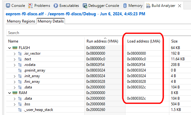

What's programmed into Flash is more than just the code - there's also all the data initialisation values.
The Build Analyser shows you exactly what's going into the Flash, and where:
Everything in the 'Load address' column is stored in Flash
.text is your executable code; some of the other things are mentioned here:

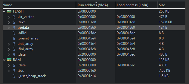

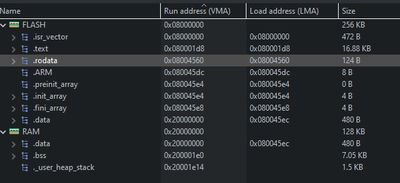

Show your Build Analyser output
2024-06-07 5:15 AM
Sure, here it is
2024-06-07 5:27 AM
@Simo_Sappo wrote:
So you have 16.88KB of code, and a total of just 1092 bytes of extras.
That's pretty insignificant - only ~6% - so what are you worrying about?
