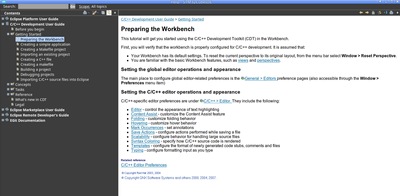

My version 1.13.1 , on Linux MX , looking at help in a topic:
Never a problem with this. :)

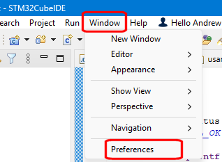

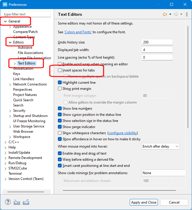

@nk2 wrote:I want tabs, not spaces.
Window > Preferences:
General > Editors > Text Editors:
Note that the CubeIDE is built on Eclipse, so a lot of things like this you can find in general Eclipse documentation - not specific to ST
But I already told help is not working. Click into topic gives blank window...

I Know. I was using Eclipse about 10-20 years ago.
It was not checked and still I had spaces. But I tried one idea - in another (my favorite) editor I changed all two spaces into tabs and after that that IDE started to make tabs as I wanted.
