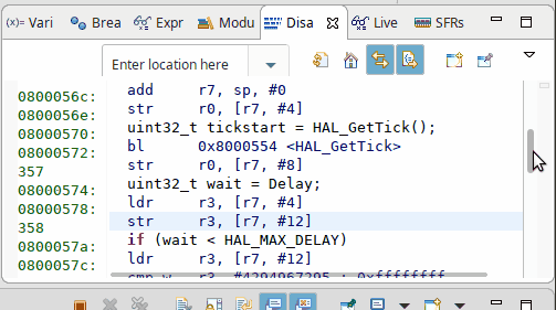

Sure, hope it helps
Linux version is Linux Mint 19,1 Xfce 64-bit
4.15.0-48-generic #51-Ubuntu x86_64
I tried it on 2 PCs same linux distro, the problem appears on both of them, but not on windows.
How to reproduce it.
Install the debian package
Create a new project, I used stm32f746g discovery, using onboard stlink debugger
Create simple blinky project, or just the template code generated by the cubemx component
Enter debug mode, debug perspective, open disassembly view
Pause program execution
Scroll disassembly window using scrollbar
Result -> only the disassembly part of the window is scrolled, the address and opcodes and function offsets (if activated) are not scrolled, they get updated if the window is resized or manually updated, or when you scroll far enough sometime it gets update
I noticed this on linux only, the same test on windows worked fine.
2019-05-06 12:19 PM

I tried it again, this time on another Linux with Ubuntu. Now, I don't have the exact same setup as you with different board and a bit different Linux distribution, but I just can't seem to get the same problem. I tried scrolling, dragging the bar as you do in the gif and at different speeds at different sized windows but it always seemed to work.
Not sure what could be the problem and why I can't reproduce it. Do you experience this problem in any other view?
Also, if any other Linux user comes across this thread. Do you experience this as well?
