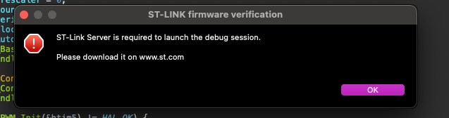

My setup is macOS 15.0 Sequoia
STM32CubeIDE 1.16.1
STLink-Server v2.1.1
When trying to program or debug a device the following error is shown:
Even after re-installing ST-Link server
I have rebooted and re-installed ST-Link Server, but the issue persists.
It's not a show stopper as I can use STM32CubeProgrammer to program the device, on the same machine.

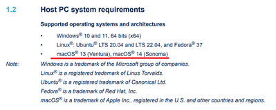

Got the answer from the team and macOS15 is not supported yet. The only supported macOS versions supported till now in STM32CubeIDE V1.16.1 are macOS® 13 (Ventura), macOS® 14 (Sonoma)
You can refer to the readme file from here.
Hope it helps.
