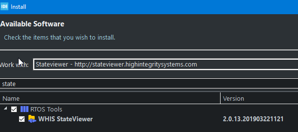

They make it hard to find, you can't download from the website, but you can install directly! :)
Add the site: http://stateviewer.highintegritysystems.com
Install RTOS Tools
2020-10-29 6:47 PM
Note: Do not open the SafeRTOS windows, they will show nothing, open the OpenRTOS windows.
