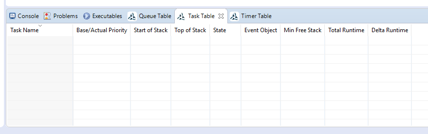

You can try the Stateviewer plugin starting from here: https://www.highintegritysystems.com/down-loads/stateviewer-plug-in/
It provides the Task / Queue / Timer table.

2019-05-13 10:17 AM
Thanks @Stefano Oliveri_O - that works fine.

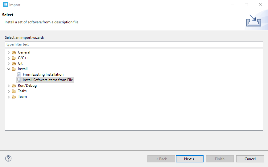

Hi Dave,
I am not in the position to answer this question because I am a FAE working with our customers to make their products. But I will say "trust ST".
At the moment I working to figure out how to migrate my projects from TrueSTUDIO to CubeIDE because one thing is very important to me is that CubeIDE is based on the latest Eclipse platform (v4.11.0), and that is enough to make an effort.
I am not seeing bugs, as you reported in your comment, but other missing features.
For the missing features can be useful the attached (p2f) file:
I hope this can help to restore your favorite IDE.

2019-09-10 10:11 AM
How does one install this plugin into stm32cubeide? The plugin, as downloaded from HighIntegritySystems, is a zip with a .dll, not a .jar
2019-09-12 8:50 AM
Figgered it out - it is included in @Stefano Oliveri_O 's .p2f clump of plugins
