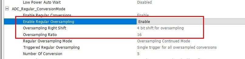

Set ADC3 with 16 oversampling
But what I got is doubled. ADC3[1] is 5V and ADC3[4] is 3.3V
In "void MX_ADC3_Init(void)",
hadc3.Init.Oversampling.Ratio = 16;
hadc3.Init.Oversampling.RightBitShift = ADC_RIGHTBITSHIFT_4;Went through the HAL_ADC_Init(), found

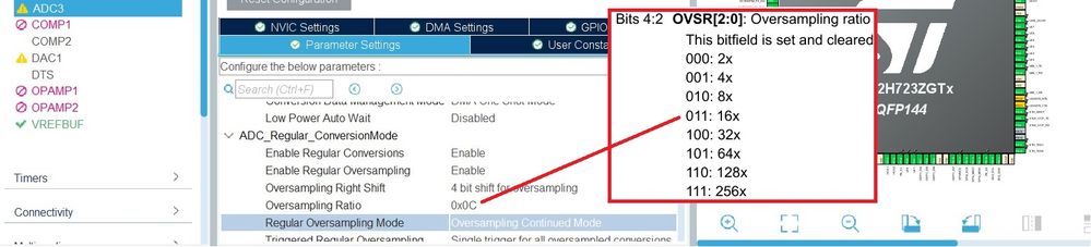

When "Ratio" is 16, it's directly written into "CFGR2" with other settings. This is not right. It's actually making a 32x oversampling.
Change the setting as "0x0C", I got what I want.
