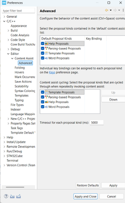

Autocomplete is not working on v2.0.0, also didn't work on v1.19.
MacOS 15.5
Macbook Pro 16"
2,3 GHz 8-Core Intel Core i9
Any suggestions?

Hello @diktril
On macOS, Ctrl + Space is NOT handled by STM32CubeIDE — it is intercepted by macOS because it is the default shortcut for “Change Input Source”.
This is why Content Assist does not appear in CubeIDE.
You need to change macOS shortcut:
- Open System Settings
- Go to Keyboard → Keyboard Shortcuts
- Open Input Sources
- Disable or change the shortcut for: Select the previous input source ; Select the next input source
After disabling it, restart STM32CubeIDE and Ctrl+Space will work normally.
I will be waiting for your feedback.
Thanks.
Mahmoud

Does the project build successfully?
2025-11-27 1:47 AM
Builds successfully.

2025-12-04 3:24 AM
Don't know what caused this setting to change. Working. Thanks.
