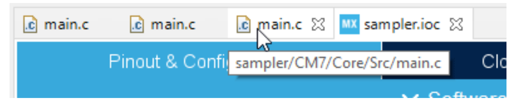

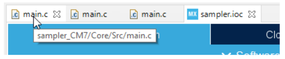

There are several issues when having project in STM32CubeIDE for STM32H747I-DISCO.
1) When you open M4 or M7 main.c file, there doesn't work the autocomplete. But when you open this file by generating code from .IOC file, those files have autocomplete.
As you can see in this gif, I have two times opened CM7 main.c. In one is auto-complete working, in one not.

2021-01-18 7:34 AM
The left and right are different main.c files.

2021-01-18 3:00 PM
> TDK : Oh, I didn't noticed this. Anyway, I guess this shouldn't happen, or is this supposed to work like this?
Not sure what you mean. If you open multiple files, they will all be shown. I'd recommend closing all files and specifically opening the ones you need when in doubt.
Autocomplete only exists when the IDE knows what to do in the specific context, which only happens if the file is in a properly set up project. Hard to know what you've got going on from the small screenshot, but clearly there are files from multiple projects open.

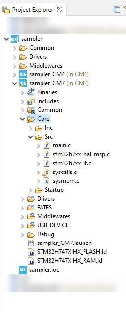

I'm sorry, let me share with you more information.
Since this is dual-core project, STM32CubeIDE creates basically 3 projects.
So, from what we can see, the first file is opened in CM7 project (path sampler_CM7/Core/Src/main.c), thus it have all required information for indexing, so autocomplete works.
Second main.c file is opened in Root Project (where inside is also CM7 project folder, so the path is sampler/CM7/Core/Src/main.c).
Actually, this gives sense why is this happening. Since IOC is in Root Project, generator is inside Root Project, so as Root Project, it will open the main.c file. But this is in the context of Root Project, so there isn't all required paths. etc.. For auto-correct. Generally, I think this shouldn't happen.
