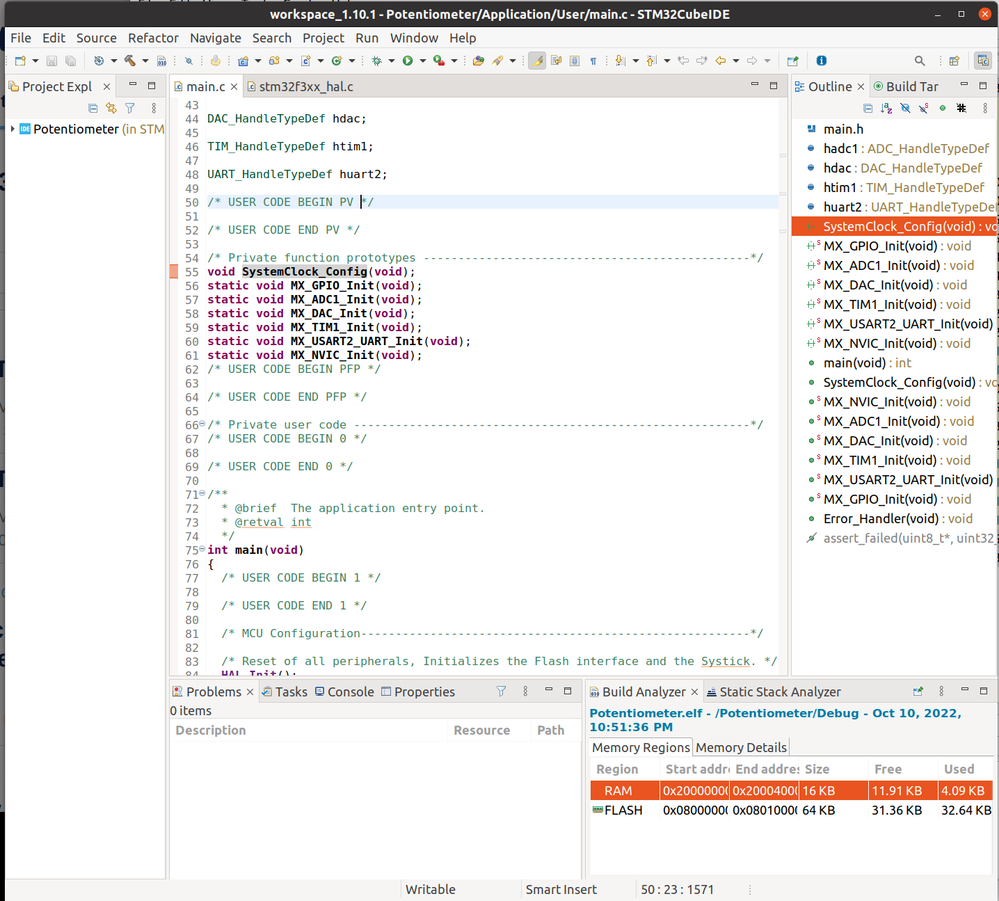

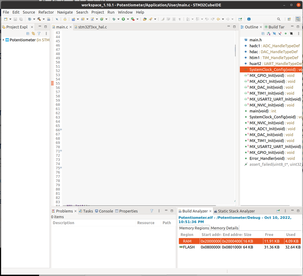

There seems to be something wrong with m newly installed SMT32CubeIDE. When my mouse cursor moves in the text editor area, it will "blink": Its content disappears for a while and then recover. In the attached two screen snapshots of STM32CubeIDE, the text editor is empty in one of them and normal in the other.

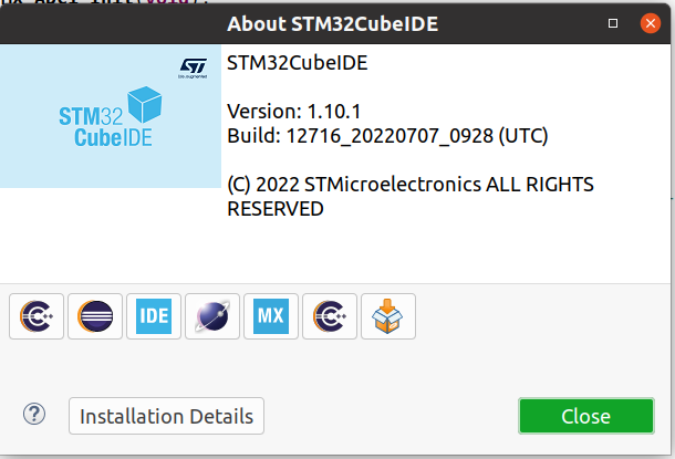

My STM32CubeIDE is version 1.10.1 under Ubuntu 20.04.2 LTS.

Fortunately I've found a solution from here:
https://www.eclipse.org/forums/index.php/t/1095683/
Change the theme to Dark.
(Window> Preferences> General> Appearance)
This solution does work for my case.
