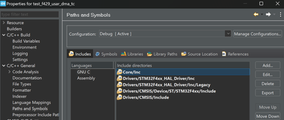

To have it find test.h when you #include it, add the folder to the include directories in project properties:
To add a folder with source code that it needs to compile, add that folder in the "Source Location" tab shown in the screenshot.

Just in case somebody has the same problem: I'm working with C++, and therefore I have setup the
path in GNU C++., like this:
Select project (in project explorer), right-click ->Properties, then go to C/C++ general and add the path.
Now the files are found.
