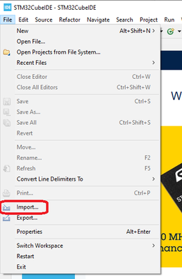

2025-01-09 12:33 AM
Try open a STM32CubeIDE project using the "File -> Import" menu.

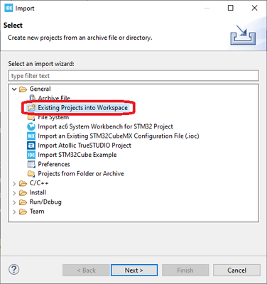

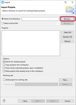

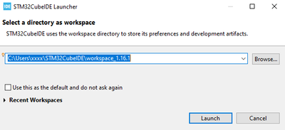

2025-01-08 5:59 PM
Hi Imen,
I've try to import the file via different methods:
And every method fail to build the project.
How can I open the projects from the CubeL5 Package ?
Thank you for your help.
