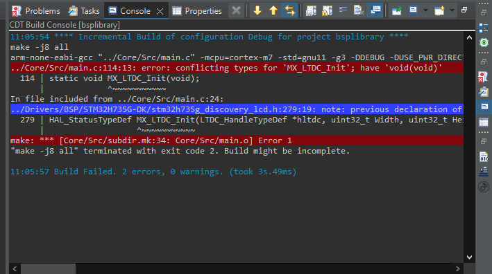

2025-03-17 4:09 AM
hello @KDJEM.1 , I don't know why, but this library is giving me an error, I’ll attach the project.
