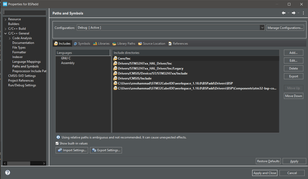

hi @KDJEM.1 , I just noticed that if I go to the project file path through Project Explorer, then Properties, and add the path, I no longer see anything in BSP and Components.

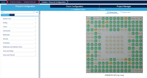

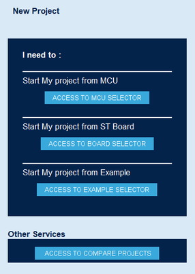

1- Open STM32CubeMX, click on “access to board selector” and choose "STM32H735G-DK" board.
2- Click “yes” on initialize all peripherals with their default mode.

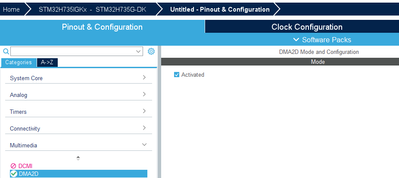

3- Enable DMA2D

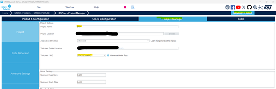

4- Click on project manager and generate code:

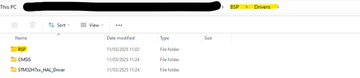

5- Create a BSP folder in your project as shown in the below figure:
6- Copy Components and STM32H735G-DK folders from STM32Cube\Repository\STM32Cube_FW_H7_V1.12.1\Drivers\BSP to \BSP\Drivers\BSP

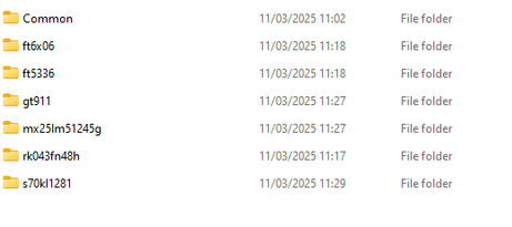

7- In the Components folder keep these folders

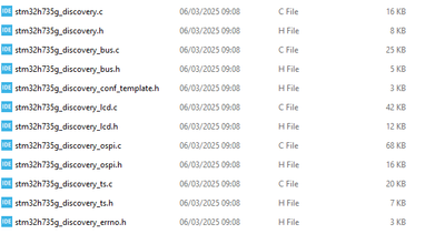

8- In STM32H735G-DK keep these files:

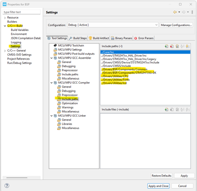

13- Add these paths as shown in the below figure:

For you project bsp32, I tested and you missed step4 "generate code" after enabling DMA2D.
Also for step 8, you forgot to keep "stm32h735g_discovery_errno.h" and "stm32h735g_discovery_conf_template.h"

Please use the same format for include path shared in step 13. it is recommended to use “/” and not the “\” in the paths.

When you start your project with STM32CubeMX, you can choose to start project from MCU or from board.
