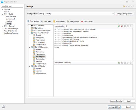

Please use the same format for include path shared in step 13. it is recommended to use “/” and not the “\” in the paths.

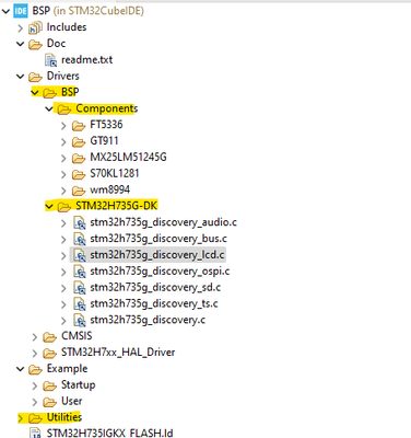

You can download the STM32CubeH7 via STM32CubeH7/Projects at master · STMicroelectronics/STM32CubeH7 · GitHub.
In the STM32CubeH7 directory go to the Drivers directory to find the BSP
Now copy this directory and paste it into the Drivers folder of your Project in the other window.
Delete the rest of the folder and keep only "Components" and "STM32H735G-DK" ones which are relative to the STM32H735G-DK board.
Now go to the Components directory and keep only the folder used in your project.
For example if you need to use only the LCD you need to keep in the Components folder only "Common" Folder and keep only the LCD drivers.
In the STM32H735G-DK, For display example, you can keep needs files as we won't use all of the features of the board.
You can get inspired from BSP example in STM32CubeH7 package under this path "STM32Cube\Repository\STM32Cube_FW_H7_V1.12.1\Projects\STM32H735G-DK\Examples\BSP"

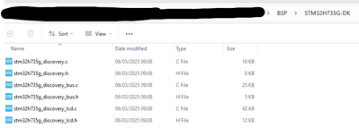

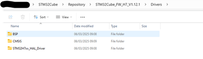

2025-03-07 7:26 AM
hi @KDJEM.1 , Is it normal that when I download the master ZIP file and navigate to drivers - BSP - STM32H735G-DK, the folder appears empty? However, when I check online, I see that the libraries should be inside.
2025-03-10 12:58 AM
Hello @zaidmoha,
Could you please refer to this FAQ to download STM32Cube packages from GitHub correctly: Downloading STM32Cube packages from GitHub correctly - STMicroelectronics Community.

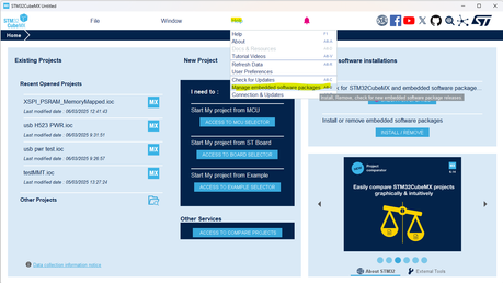

Also you can download the STM32CubeH7 from STM32CubeMX or from here.

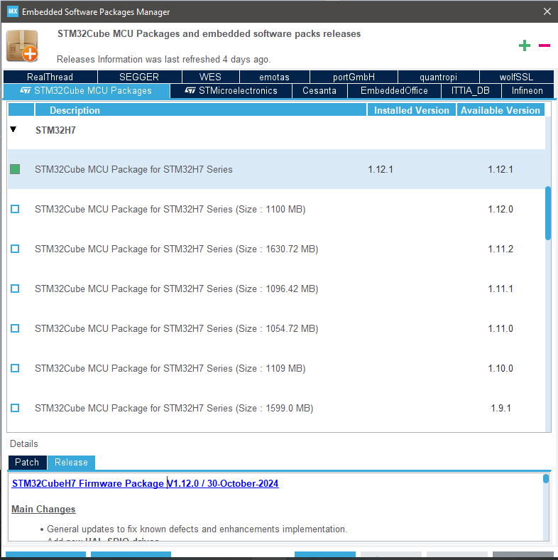

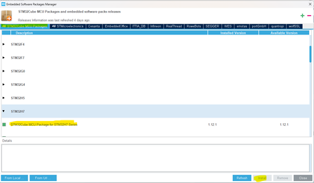

2025-03-10 1:09 AM
Hello @KDJEM.1 , I really appreciate your availability, but i checked, and it shows me that the packages are already installed.
2025-03-10 2:18 AM
Hello @zaidmoha,
Thank you for updating this post and glad to know that the STM32CubeH7 is already installed.
Now, I recommend you to refer to my replies and the steps shared in my comments to add the BSP drivers.

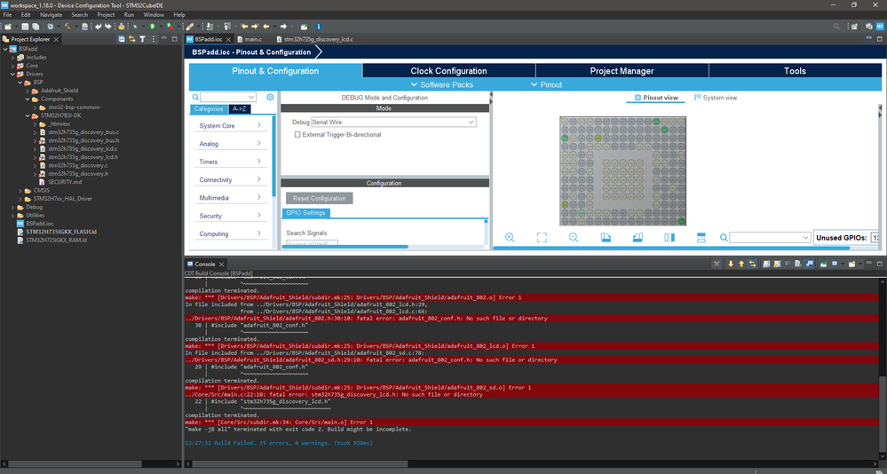

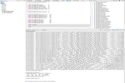

2025-03-10 4:29 AM
2025-03-10 4:51 AM - edited 2025-03-10 4:51 AM
Hello @zaidmoha;
Please share your project, as I mentioned in my latest reply.
Make sure that you add the include paths for BSP drivers.
Thank you.
