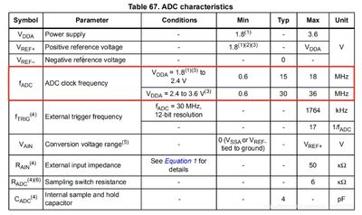

2024-09-27 8:27 PM
HI, thank you for your response. Based on my calculations, the highest sampling rate I can achieve is 2.4 MSPS (36M/15). According to Nyquist's theorem, if I need to sample 1024 points for a 10kHz sine wave, the required sampling frequency would be 10k * 2 * 1024 = 20.48 MHz. If I reduce the FFT requirement to 100 points, then the required sampling frequency would be 10k * 2 * 100 = 2 MHz. Does this mean that I cannot meet my requirements using the STM32F429?
2024-09-27 8:31 PM
HI, thank you for your response.I made a mistake in the values; the APB2 is 72 MHz, and as shown in the figure, the maximum achievable rate is 36 MHz.
2024-09-27 8:37 PM
Yes, you cannot measure a 3 MHz sine wave with a sample rate of less than 2x that frequency, or 6 MSPS. That is beyond the capabilities of a single ADC. You can do dual or triple interleaved mode, but the programming and post-processing is considerably more complicated. You will have considerable noise on the circuit as well at those speeds. Might be better ways to accomplish what you want. Probably aren't going to be able to take an FFT continuously at those rates, but you could do snapshots.
