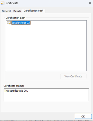

2025-10-24 7:25 AM - edited 2025-10-24 7:26 AM
Hi, fallowed same steps, only one Zscaler is there in certmgr and exported, still same issue.
>> Restarted vs code

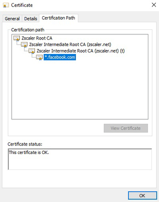

2025-10-24 7:35 AM
AFAIR there should be at least 2 certificates, the Zscaler Root CA and the Zscaler Intermediate Root CA, as shown in this screenshot (again picked on the Internet):
2025-10-24 7:44 AM
only one is there.

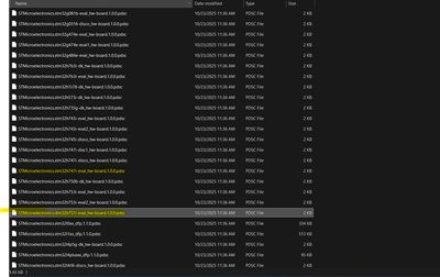

these packs available looks like is this correct?
2025-10-24 10:38 AM
only one is there.
I wonder from where you get this screenshot. If from the Windows cert manager then I think it is expected since you only view the selected certificate. But if you get the certificate by clicking on the lock from a browser you may get more certificates in the chain.
Packs are installed under %AppData%/Local/stm32cube/packs/STMicroelectronics/.
