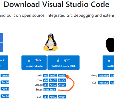

I have fixed things by switching from the snap version of VScode to the .deb version (which required temporarily changing the toolchain so that cmake could find ninja again).

Well, I got the Snap through my distro's app center and the .deb from code.visualstudio.com, rather than from code.visualstudio.com/Download, but yes.
