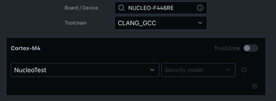

I created a project by selecting CMake as the toolchain and ST-ARM-CLANG as the compiler using the STM32Cube extension for VS Code (3.7.0) on macOS. Attached below are my configuration settings.
