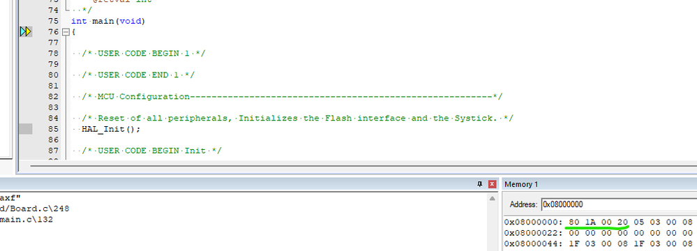

Yes, you are absolutely right, error was in my code because the function variables were on the stack.
And it worked in my projects because Keil doesn't allocate a stack, like GCC And this is the way to UB
I attached screenshots where the bootloader starts with 0x08000000 and stack like in map file
__initial_sp 0x20001a80 Data 0 startup_stm32f765xx.o(STACK)
My Keil sct file
