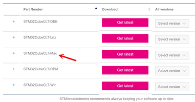

MAC BOOK PRO is using apple silicon(arm), i downloaded STM32CubeCLT-mac, but it seems installation is not sucessful, maybe it because it's x86/amd64 version.
Do ST have plan to release STM32CubeCLT apple silicon version?

@Peter3718, Yes we plan to have STM32CubeCLT for Apple silicon. I can't communicate any fixed date though.
In the meantime the current CLT version for MacOS should work if you have Rosetta installed.

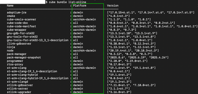

2025-10-25 6:16 AM
@Julien D I also noticed with the new 3.x.x plugin the tooling bundles are also not compiled for Apple Silicon. CMake throws a CPU error if rosetta is not installed. Is this also going to be fixed in the future?
2025-10-25 6:25 AM - edited 2025-10-25 6:25 AM
Yes, no choices. Rosetta will be discontinued sooner or later.
The amount of native aarm64 bundles will grow during this transition period.
