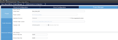

it looks like it does allow me to do that (change to CMake) if I open it from standalone CubeMX but not from the CubeMX inside CubeIDE. Inside the CubeIDE's CubeMX-plugin it shows greyed out as you can see from the attached screenshot.
It does that for all projects, so it is a CubeIDE bug I assume?

2025-04-15 6:18 PM
AFAIK, only the standalone CubeMX can generate projects for CMake. This is a feature, not bug ))
2025-04-16 6:20 AM
Thank you @Pavel A.
that is correct, I just found that out yesterday in another post.
