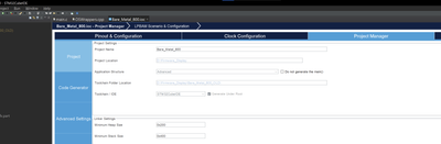

it looks like it I can do that from standalone STM32CubeMX but not from the CubeMX inside CubeIDE's CubeMX Extension/Plugin. Inside the CubeIDE's CubeMX-plugin it shows greyed out as you can see from the attached screenshot.
It does that for all projects, so it is a CubeIDE bug I assume?

Hello @Ricko
It's not a bug .
the CubeMX plugin within CubeIDE is meant to generate projects for STM32CubeIDE only.
THX
