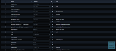

I remember that when I first used the extension, these tools were all specified through scripts. However, after using it for a period of time, I found that CMake, programmer, and other tools could not find the specified paths, so I had to add them all to the environment variables.
2025-12-27 2:29 AM
@LionC

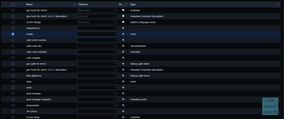

According to me first snapshot shows your first project setup i.e. tools locked / assigned to this project.
Second snapshot shows what tools are installed on your local system ... no the ones locked / assigned to your second project.
Comparing pears and apples here.
Assigning tools to a project is for sure not requiring to install them back. They are already on your system what's fine. Assigning / locking is just making explicit which tools your project has to rely on. You may want to use one toolchain for a project, another for the second etc etc.
Assigning / locking tools to a given project is populating for you under the hood the local $PATH variable ...

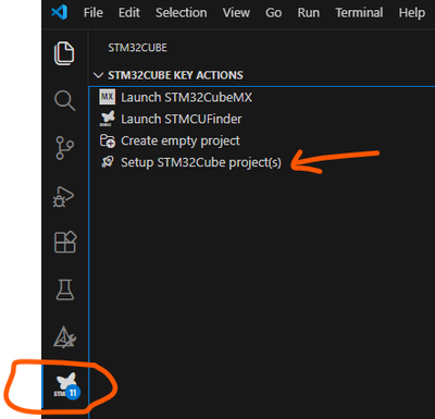

In short one setup step is missing to you for your second project. Let's have a try to force it:
2025-12-27 11:50 PM
There is a system wide bundles store and a per-project list of used tools (bundles).
Both can be viewed via the bundles manager view.
Your second screen print seems to show the system wide bundles store.
