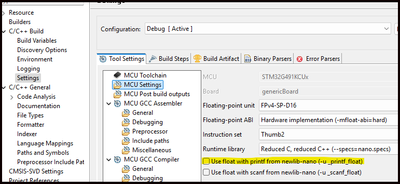

I don't have all of these options availlable. here is what I see:

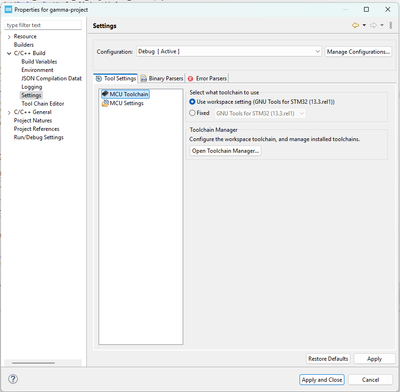

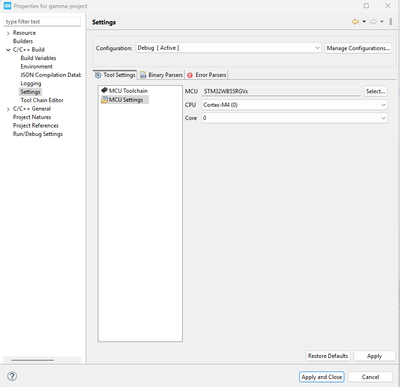

My project is using CMake, and builds correctly. The error seems to be coming from STM32CubeIDE error parsers, not my build configuration.

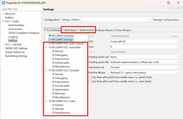

Did you import this project? Or did you start a new project, write code and run into this warning about the float?
I'm not sure why you're missing these sections?
