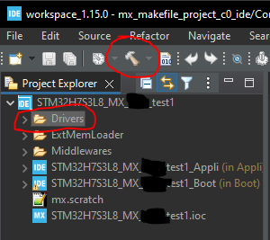

If I remember well, CubeIDE being Eclipse/CDT-based also derives the "active context" from which file is open in the editor.
Above is an example in CubeIDE where we have shared folders inside a "hierarchical" project structure. Notice that the hammer build icon is greyed out when the shared Drivers folder is selected. Same thing if I open a shared c-file from that folder. But if I open the same folder when it is linked inside one of the "child-projects" then CubeIDE understands the context and will enable and execute builds properly.
