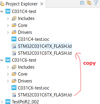

yes it was bother for me too.
now the way I choose is as followings..
1. create empty project which use compatible MCU.
2. copy linker script file (*.ld) into proper project.
3. select linker script with "Properties - C/C++ Build - Settings - MCU GCC Linker" menu.
that gives less frustrates.
