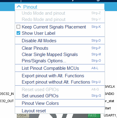

if i select in MX "List Pinout Compatible MCUs"

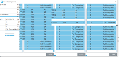

i get this:
Sometimes STM32CubeIDE closes without warning.
i reintalled the ide, i delete the workspace, i restart the pc, nothing helps! i change in the properties from external bowser (chrome) to internal, nothing.
Any suggestions?

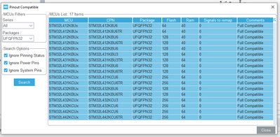

2023-11-21 3:32 AM
If i do the same in 1.12.1 i get this
And this seems ok.
So i think it is one more issue in 1.13.2 :(

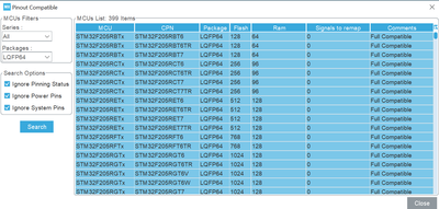

2023-11-21 4:36 AM - edited 2023-11-21 4:37 AM
I don't think so. Doing this operation with the version 1.13.2 I got this:
Can you check your internal parameters?
Best regards.
STTwo-32
