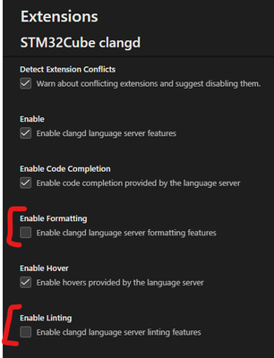

Although there are several ways to bypass the formatting process, the next update of the STM32CubeIDE for Visual Studio Code extensions will disable formatting and linting processes by default. These processes are currently enabled by default by clangd services. The update is expected in a few weeks.
A formatting feature may be included in the long-term roadmap but for now, we do not want to contribute here because the marketplace already provides facilities about.
Regarding your suggestions, please share any areas for improvement. We are eager to receive feedback - even if long list -. The upcoming update is Thanks this post feedback we have received. We cannot commit to serving all requests because supporting a collection of profiles requires making choices. However, we want to be driven by end user needs.
