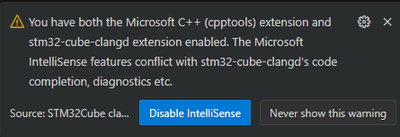

Making me click on a notification isn't a solution...
The message in that notification mentions disabling intellisense, but the formatter IS NOT intellisense.
I don't see it written anywhere: "WARNING: If you disable C/C++ intellisense, your default formatter will become STM Clang, and you may end up with differently formatted code."
These three lines in the documentation would have been enough to solve all the problems and allow users to make informed choices.
It won't be possible to prevent installation if another extension is already present, but since you recommend installing the full package of all extensions at once if the goal wasn't to force the use of your extension once installed, when you run the conflict check, instead of asking me to disable the C/C++ extension with misleading messages, you could have disabled STM Clang.
Finally, the default format used by the STM Clang formatter is not even the one you use for your libraries or in the code generated by CubeMX. If you really want to have your extension used by the user, disabling one of the most used extensions in the store, at least ensure that you are consistent with yourself.

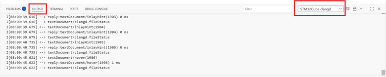

@CSharpino The clangd version I believe that the ST fork uses is 19.1 so you could use options at version 19 and below, but you will know if it doesn't work when your formatting fails and reverts to the LLVM style.
Alternatively, you can check the output of the clangd tool by selecting the STM32Cube clangd as in the screenshot below.
It can tell you exactly why the formatter failed.
Suffice it to say, you should be ok using that file I gave you. Look through those options and tweak them that suits you.
