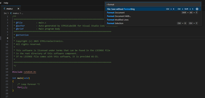

But I wasn't starting from a situation where I didn't have a default formatter; my formatter (like that of many others) is the one provided by the Microsoft C/C++ extension, as shown in the image.
This formatter, however, is disabled by the STM extension's request to disable the C/C++ extension's intellisense because it conflicts with yours, essentially forcing your extension to become the default.
The solution I found was to delete the STM32 clang extension and re-enable C/C++ intellisense.
However, these forced changes should be avoided or at least documented to avoid wasting days of work, given that the C/C++ extension has 90 million downloads, so it's quite likely present in people's VSCode.
