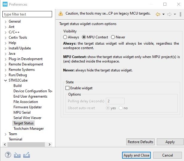

@ASay.1 what is your setup here (target status) ?
Maybe some tricks ...
2021-07-02 4:21 AM
MPU Context
2021-07-02 5:48 AM
@ASay.1 Some extra question trying to get your context.
MPU context setup ok Thanks for sharing. What about your workspace content then ... any project dealing with a STM32MP1 device ?
