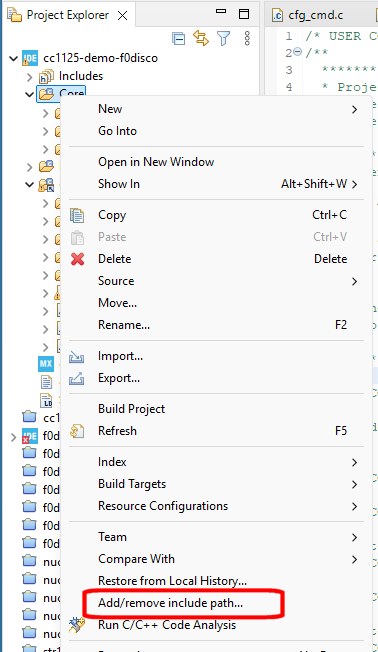

2025-11-28 6:31 AM
Right-click a folder in the Project Explorer:
I would hope that would do things "properly" ...

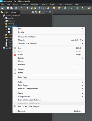

2025-11-28 6:59 AM
The Add/remove include path... option is not clickable...
